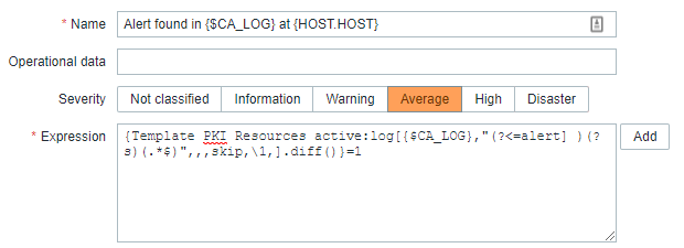

    • A trigger set to fire when there is a difference between current and previous values:
    Normally, this setup works as expected, but there is a specific scenario where the trigger wont fire, although the item does register the value in the history:
    When a new server is launched, it auto register itself, and is then associated with the template containing the item and trigger.
    At that specific scenario, when the very first alert appears in the log file, the item will register it, but the trigger won't fire. I suspect it this is because it is the first line in the item's history list and the
    diff()
    function is thus failing.
    When the next line with the work "alert" appears in the log, the trigger will fire as expected. Furthermore: It I'm clearing this item's history and then push a new line with the word "alert" to the log file, everything works as expected.
