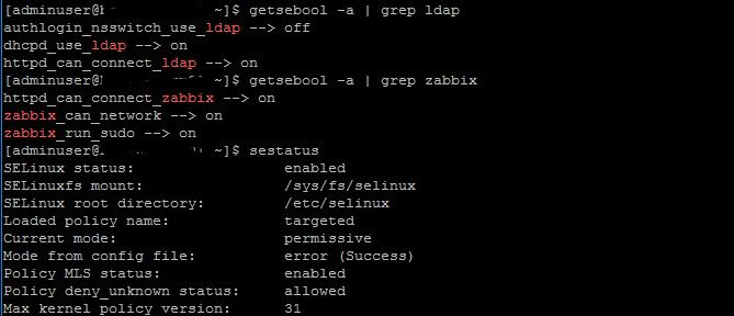

        selinux ? enabled ? try to disable it and check - I had weird moments with it

          I have currently selinux set on permissive, to at least get these error sources out of my feet for now
          also set the sebools for the point in time when I take the step to get selinux back into enforcing mode again
