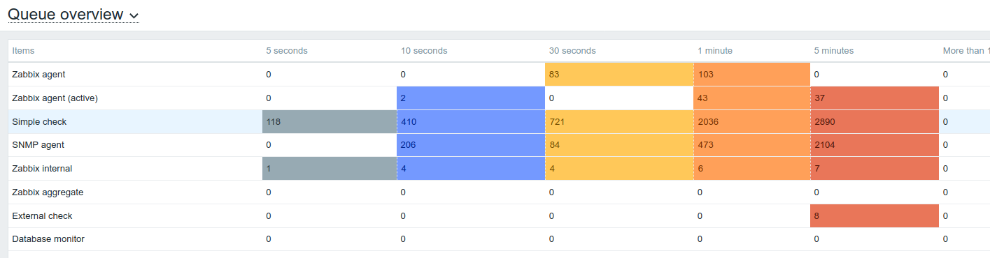

                              • mbuyukkarakas
                                • Aug 2014
                                • 49
                                #30
                                Hello all,
                                A few months ago I installed a large set of zabbix servers (3 apps with zabbix v5.0, 1 database server with postgresql v11 and 3 proxies.)
                                The system runs generally with 500 nvps and the proxies with almost 70/80 nvps.
                                Unfortunately I have almost the same problem. The proxy queues are growing and I cant find the reason.
                                For each of the proxies at least 1000 to 2000 waiting items are showing up.
