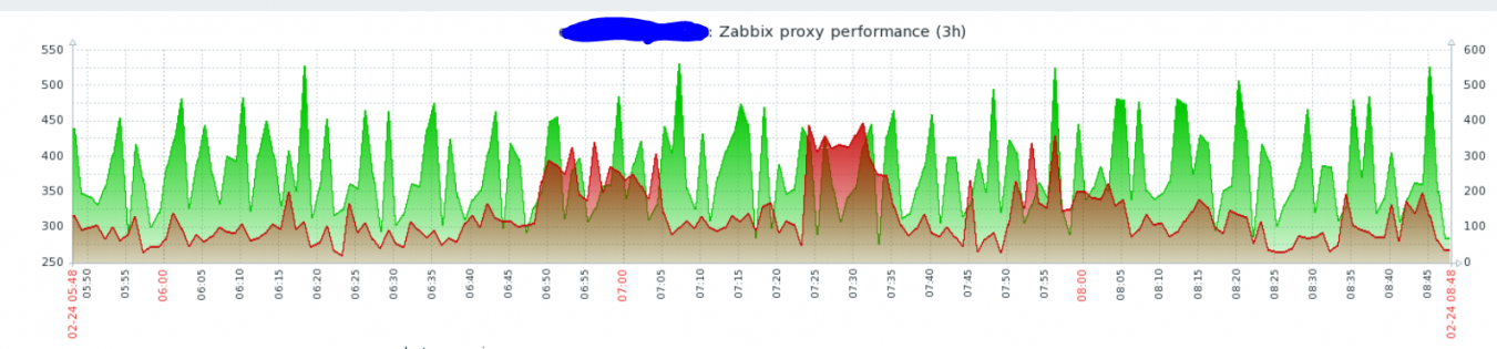

          I have found out that this seems to be a problem with something else, not with this trigger. Actually, there seems to be a problem with the performance, but I have no idea why. From time to time, is seems the proxy is not able to handle all the messages and in that time there is a lot of false warnings that the items have missing data for more than 10 minutes. I understood it like the proxy receives the data, but is not processing it. Here is the performance graph.When the queue (the red one) is big, we run into issues. Any idea why is this happening? CPU and memory are almost unused.. Thanks for your time!

            What version of Zabbix? Check the server performance graphs during the same times. Is housekeeping active?
            • ukarm105
              • Feb 2020
              We use Zabbix 3.4.4. I also checked all graphs and cannot see any relation between the performance graph and any other.. What is housekeeping?

                  Housekeeping is a Zabbix subsystem that is responsible for cleaning out old or outdated values. See: https://www.zabbix.com/documentation...oncepts/server
                  Dealing with the 'history' and 'trends' data is something that sites have periodically had issues with. Various schemes (like database partitioning) exist to reduce the I/O load that old value cleanup places on your system.
                  On a standard install, if housekeeping isn't running frequently enough, then when it does run it has a *lot* of work to do, so it can cause I/O issues for other processes. You don't want to run it *too* frequently though.
                  Note: housekeeping happens on your main Zabbix server.
                  • ukarm105
                    • Feb 2020
                    Thank you for your response. So I check the graphs and can see this - graph for last 6 hrs, the issue is present - is can bee seen in a performance graph as the queue is high. As you can see the housekeeper is scheduled for each hour to process old data. The issue we have - the problem More than 100 items having missing data for more than 10 minutes.. is like for last 3 hrs now. Can you see something suspicious?
