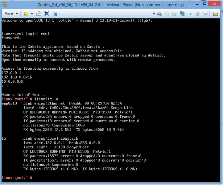

    I am trying to install the Zabbix appliance for the first time. I have worked with VMs and Linux before, but am a bit limited/rusty at both.
    I have tried both VirtualBox and VMware Player. I can boot the VM and get the login prompt, but once I log in, I receive the following error.
    eth0: error fetching interface information: Device not found
    lspci -vv | grep Ethernet
    00:12.0 Ethernet controller: Intel Corporation 82545EM Gigabit Ethernet Controller (Copper) (rev 01)
    I tried changing all of the Network Adapter Settings in the VM Settings, but no luck.
    Any help would be greatly appreciated.

    What does 'ifconfig -a' output?
    • jpull
      • Nov 2014
      Please see attached for ipconfig -a.
      Let me know if you need any more information.

          Two things you may look at.
          1. Make sure you have a nic card assigned to the server in VMWare.
          2. Go in to YAST/Network Devices/Network Settings and set up your IP address, Default Gateway and Subnet Mask

            • baffled
              • Feb 2015
              I think this is just for information. You should be able to change the script to use your ethernet adapter device (enp0s18) in place of eth0.
