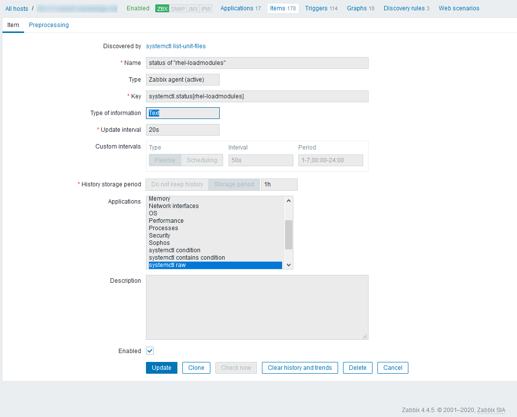

        Could you please be so kind and provide more information about item with itemid 71907 what kind of triggers are there created for it and how big is range in that trigger ? Also what kind of data is received on that item, is there data with 0 timestamp ?
        • grommir
          • Mar 2013
          • 134
          In this case, it's the status of the Linux service "rhel-loadmodules". But in fact, it can be any item.

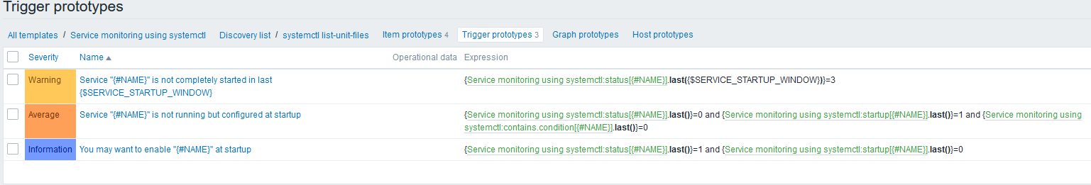

ID:	409871 There are three triggers configured for this item type:
