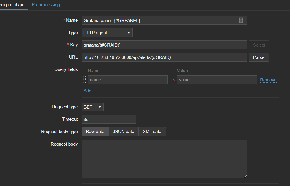

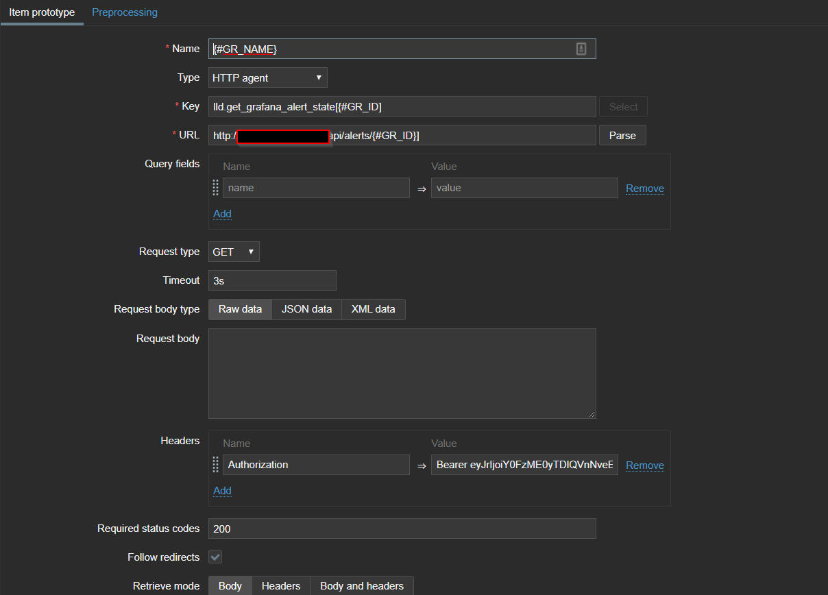

    And the item prototype:
Name:	2020-02-26 11_04_36-Zabbix_ Configuration of item prototypes.png

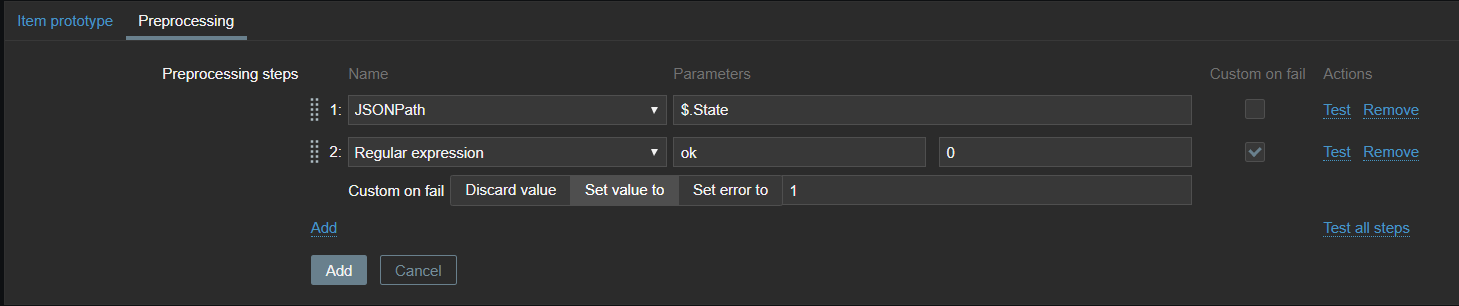

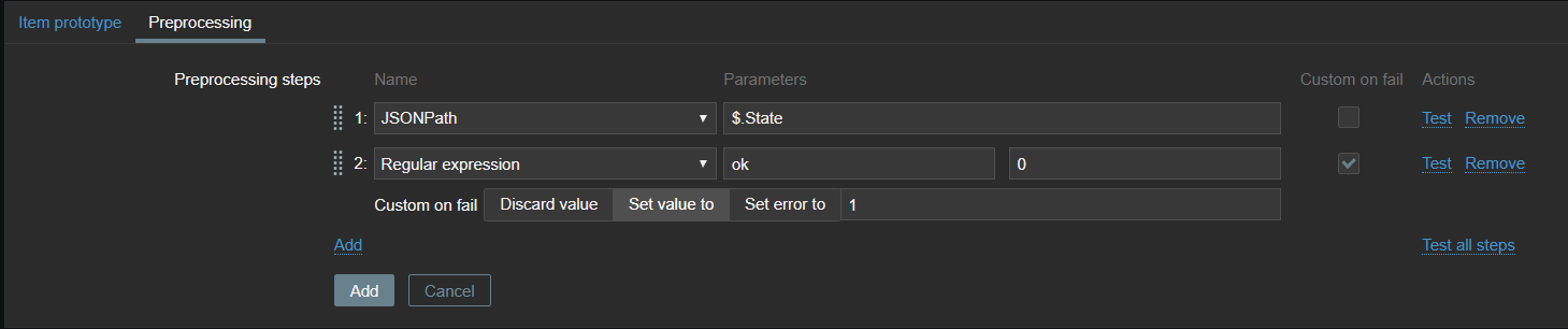

    with the following preprocessing steps:
    Click image for larger version  Name:	2020-02-26 09_49_00-Zabbix_ Configuration of item prototypes.png Views:	0 Size:	22.8 KB ID:	396363

      Item prototype has been changed accordingly:
