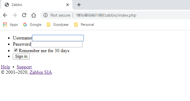

    If I then try http://[host ip address]/zabbix/index.php, I see the screen but there is no styling.

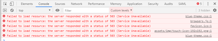

    Using Chrome browser I opened the developer tools and see several 503 errors (service unavailable) in the console.

    Researching this, I've found where I may have to change the owner and set permissions so I
    chown -R apache:apache /usr/share/zabbix
    chmod -R =x /usr/share/zabbix
    That has not helped.
    There are no errors in either /var/log/httpd/access_log or error_log. I've enabled php to log errors, `error_log = /var/log/php/php_errors.log` and created the parent directory /var/log/php, but no file has been generated
    I'm not sure what else to do.

    I think the chown/chmod you did probably did more harm than good. You might want to consider an uninstall/re-install of the zabbix-web package, to get back to default permissions there.
    Nothing from your config jumps out as being "wrong". Did you compare the httpd24-example.conf from zabbix-web to yours, to see if there are any obvious differences that might be the cause of the issue?
