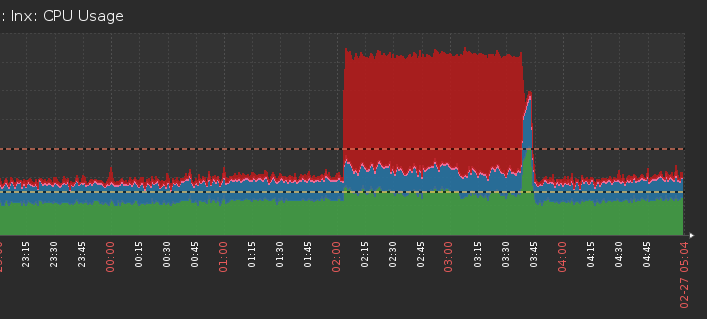

    I setup Postgresql with timescale partitioning and it`s look very good.
    But one day I noticed strange behavior:
    every day on DB-host in 02:04 I have many IOPS read & cpu iowait and so on.

    So in this period of time, as I see, in db log:
    2020-02-27 03:39:04.778 EET [104465] ERROR:  could not open relation with OID 1561123
    2020-02-27 03:39:04.778 EET [104465] STATEMENT:  SELECT MAX(h.clock) FROM history_uint h WHERE h.itemid='69466'
    2020-02-27 03:39:04.777 EET [103891] ERROR:  could not open relation with OID 1561123
    2020-02-27 03:39:04.777 EET [103891] STATEMENT:  SELECT MAX(h.clock) FROM history_uint h WHERE h.itemid='69466'
    2020-02-27 03:39:04.777 EET [102314] ERROR:  could not open relation with OID 1561123
    2020-02-27 03:39:04.777 EET [102314] STATEMENT:  SELECT MAX(h.clock) FROM history_uint h WHERE h.itemid='69466'
    2020-02-27 03:39:04.777 EET [104464] ERROR:  could not open relation with OID 1561123
    So I tried to run "explain analyze" in this period. Its says: in ordinary goes to "history_uint_1" index, but in that time - to "history_uint_clock_idx";
    Why it`s happening? How to debug? It`s some of Zabbix works?
