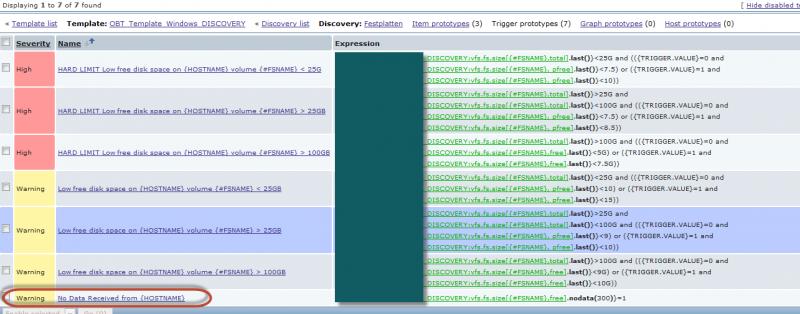

We have a Discovery Template that has a Discovery which creates items for all Disks. This will create a Trigger for measuring the Disk Size and Free Disk Space.
With the Discovery we created a "No Data" Trigger on the discovered disk for Free Disk Space.
Now when i look at the Problematic machine there are two "No Data" Triggers, one that Looks for " No Data" on the Free Disk Space and one that Looks for "No Data" on Total Disk Space, which is not part of the Template.
On the attachement (Discovery_Template) you can see the Template
And the other (Machine_Triggers) Shows the Triggers that has been created on the machine itself
