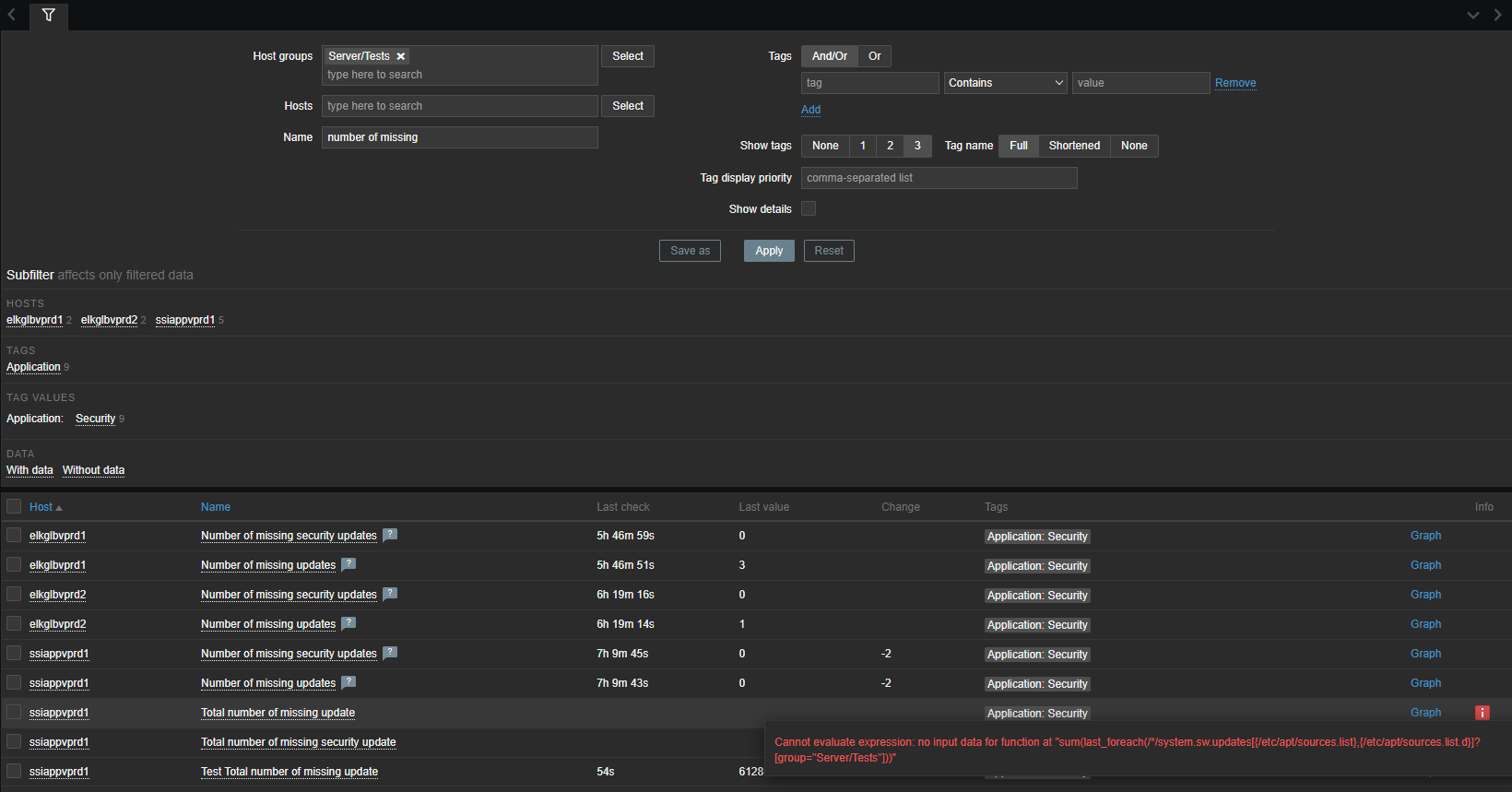

                        Thx for the help. My version is v6.0.xx, so I changed my expression with :
                        sum(last_foreach(/*/system.sw.updates[{$SYSTEM.UPDATE.SOURCELIST.STANDARD},{$SYSTEM.UPDATE.SOURCEPARTS.STANDARD}]?[group="Server/Linux servers"]))
                        I can create the item onmy selected host, but when I look at the Latest Data, I have this error on the item :
                        Cannot evaluate expression: no input data for function at "sum(last_foreach(/*/system.sw.updates[{$SYSTEM.UPDATE.SOURCELIST.STANDARD},{$SYSTEM.UPDATE.SOURCEPARTS.STANDARD}]?[group="Server/Linux servers"]))"
                        Any idea ?

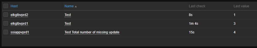

                        • sbocquet
                          • Mar 2020
                          • 12
                          After some more tests, it seems that there is a problem with the macro parameters on the items I want to sum.
                          If I add a new key on some test hosts that does not have parameters, like this :
                          UserParameter=system.sw.test, apt-get -s dist-upgrade -o Dir::Etc::SourceList='/etc/apt/sources.list' -o Dir::Etc::SourceParts='/etc/apt/sources.list.d' | sed -n 's/^\([0-9]\+\) upgraded.*/\1/p'
                          And now, I create a new "sum"
                          sum(last_foreach(/*/system.sw.test?[group="Server/Tests"]))
                          It works !
                          So... Can macro parameters be used when using the aggregate function ?​
