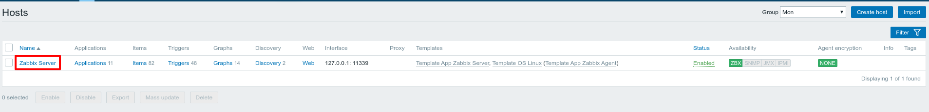

        {HOST.HOST} is translated to the name of the host, see picture:
        Click image for larger version  Name:	host-host-macro.png Views:	0 Size:	37.2 KB ID:	397431
        Yeah, and this:
        Macro Value
        {$SSL.DNS} {HOST.DNS}
        won't work because macros are not supported in macro values.
