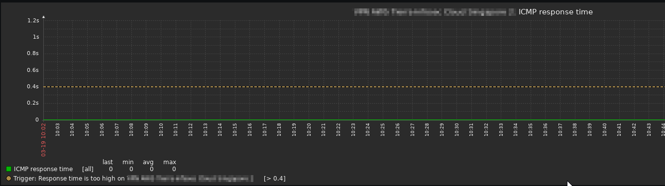

    this is a graph with a time range of 1h. It's what I expect: a line with all 0

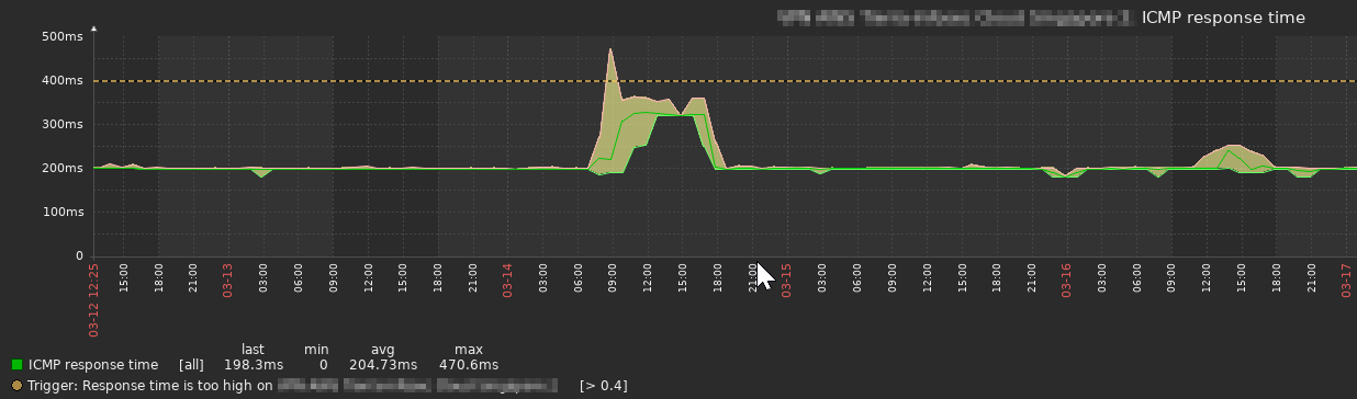

    this is the same graph with a time range of 7days. The line is around 200ms, and I can see the values collected (198.3ms, 470.6ms ...).
    Someone can explain this behaviour?

    it's just a problem of cutting screenshot, the second screenshot goes also to date 3.19.
    However, the problem is not the comparison. The question is: how can trends calculate an average of 200ms if the collected values are all 0's ???
