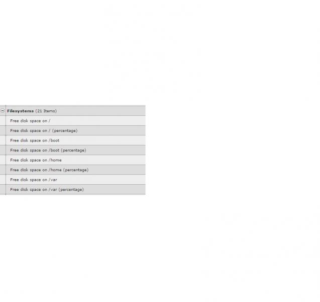

    I am having issues with the low level discovery for the file system monitoring. It shows all of the disk except for one on the web page.

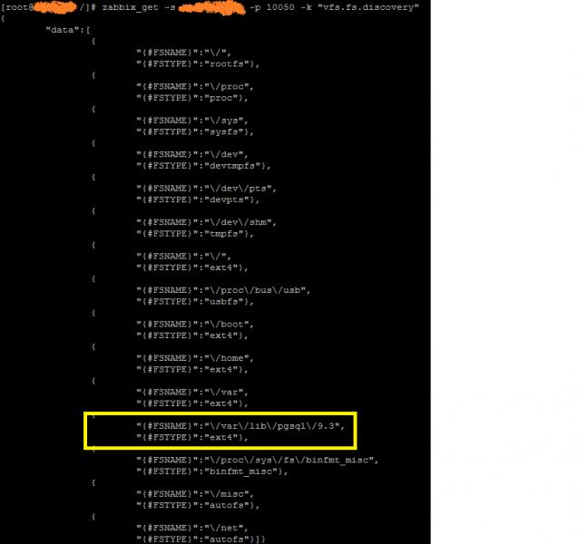

    If I run 'zabbix_get -s xxx.xxx.xxx.xxx -p 10050 -k "vfs.fs.discovery"' from the monitoring server it detects the disk. (see screenshot zabbix1.jpg) The one that is not showing is boxed.
    Also attached screen shot of what the web page is showing, it show disks /, /boot, /home, and /var
    Montoring server OS is Centos 6 running zabbix 2.2.1 all agents are also running version 2.2.1 on CentOS 6.
    Thanks in advance,
    J

    • JKx2
      • Dec 2014
      Hi Aleksey,
      Thanks for the reply.
      I looked at the discovery rule and filter for the Macro is set to '{#FSTYPE}' and the regexp is '@File systems for discovery'
      Thanks,
      J

        Regex Perhaps
        When looking at differences between the disk you are having issues with, and the rest of the disks, I noticed that the "9.3" included a period (.) which is used in regex patterns. Could you create / add a bogus disk, that has the period used as part of it, then see if it also fails?
        • JKx2
          • Dec 2014
          Thanks for the suggestion, I think this it. I mounted the same filesystem under /mnt/pgsql93, and it got discovered accordingly.
          So there must be something on the server-side web page display side that doesn't like the period '.' in the mount name.
          The directory structure is created by the CentOS RPMs, so I would prefer not to change it. I will probably make the mount one level higher (at /var/lib/pgsql), or just keep the second mount as a permanent solution, though that is not the most elegant solution...
