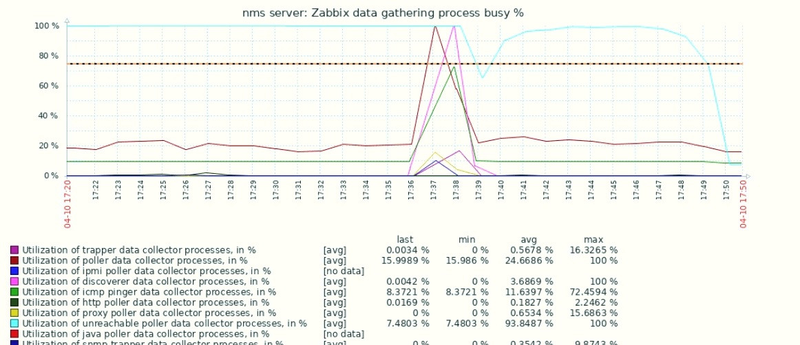

          I've figured out the issue now, it was due to high number of unreachable devices in zabbix environment which lead to 100% Utilization of Unreachable pollers. After disabling the unreachable devices(almost 50% of hosts were unreachable) the Unrechable poller utilization decreased significantly as show in screenshot. After making changes SNMP availability was quick enough.
          Also updated zabbix configuration by increasing Unreachable pollers count, now after enabling all the devices the utilization of Unreachable pollers was about 60% and SNMP availability is responding as configured.
          Thank you all for your support!
