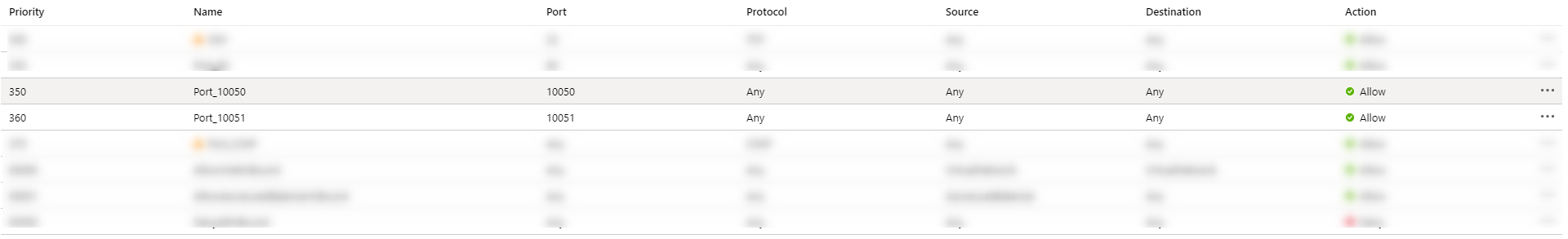

    Does the firewall on your cloud-based Zabbix server allow incoming connections on port 10051 from the IP address for your new Zabbix proxy?

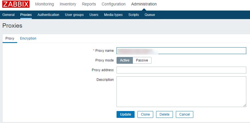

    Did define the new proxy as an "Active" proxy in Administration->Proxies on your Zabbix server?

      Hi Tim,
      attach the screen of firewall on azure server, for the moment I have a single rule that open 10051 port from any
      Attach also teh screen of active proxy configuration

        I was expecting that it would be required that you specify the proxy address for an active proxy, but the proxy setup documentation implies that if you leave it blank then any active proxy can connect. I guess I would never do that when running the Zabbix server in the cloud, because it allows anyone to impersonate a proxy and potentially download information about your clients that are monitored by the proxy.
        What happens if you fill in the IP address of the new proxy and update that proxy config in Administration->Proxies? Does it make any difference?
        Also, does the HostName on the proxy exactly match the (obscured) proxy name in the Proxies config? The docs say that's a requirement.
