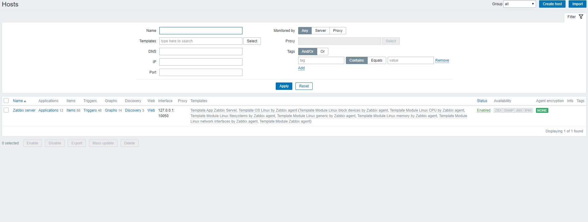

    Hello guys, so sadly I have some problems with starting a zabbix. I installed it like day ago and still didnt manage to make it work without problems.
    Web interface is working fine, but it doesn't detect that my server is running.
    Even though it seems like it detected the server
    All my settings are default, I dont know what is wrong. I a db schema without a problem, started a web interface without any big problem but this is stopping me from using Zabbix.

    To my understanding, the green flag on the screenshot listed under "Agent encryption" "None" is related to Zabbix Agent of this Host - and has nothing to do with Zabbix Server.
    Are there any relevant messages in
    sudo tail /var/log/zabbix/zabbix_server.log
