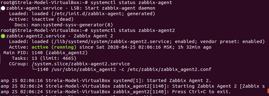

    6. I made a basic setup /etc/zabbix/zabbix_server.conf and /etc/zabbix/zabbix_agent2.conf and started the services.

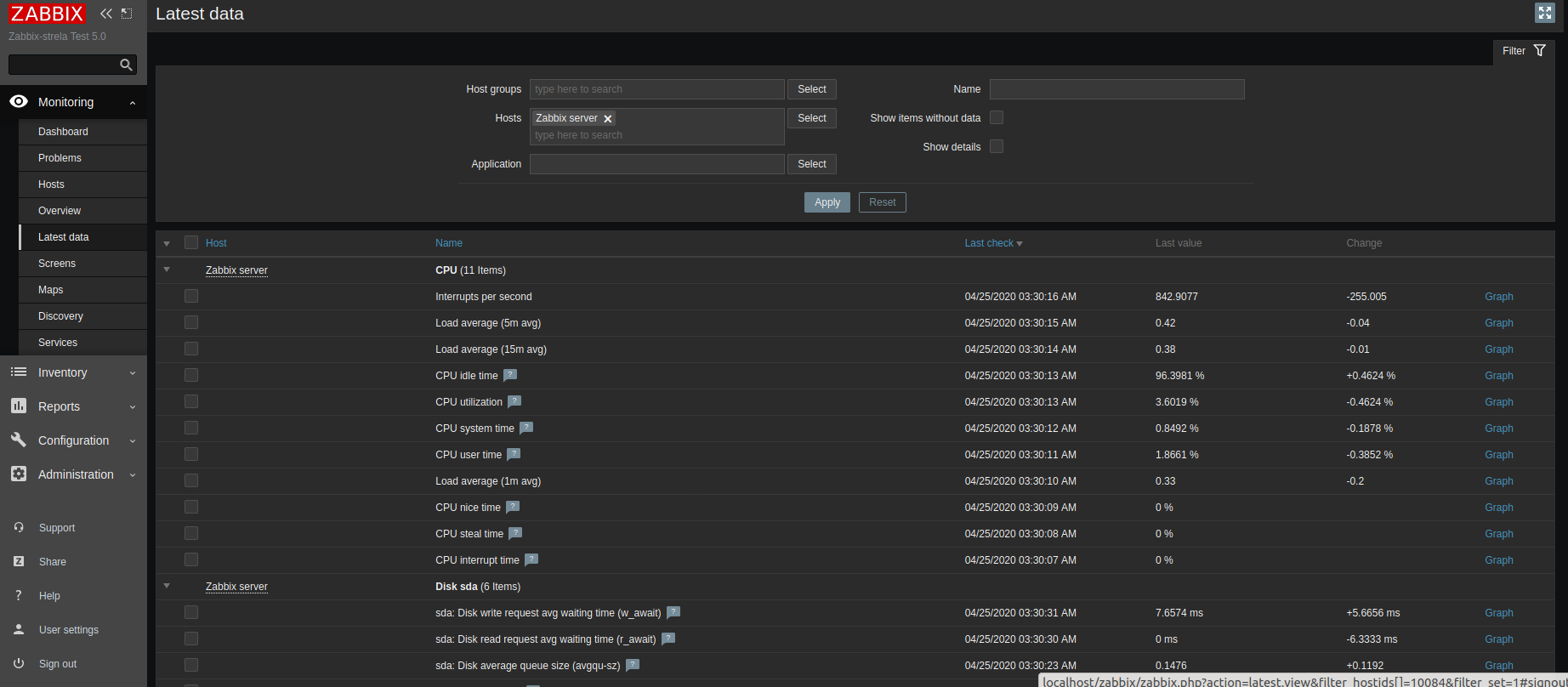

    Zabbix gets other data:
