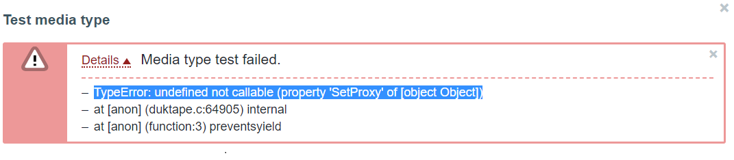

    I'm trying to setup VictorOps integration in our company using Zabbix 4.4.8 with WebHooks MediaType.
    I'm following this guide
    https://help.victorops.com/knowledge...x-integration/
    In Zabbix Server we do not have direct connectivity to alert.victorops.com so we need to use a proxy for that.
    So, reading some zabbix documentation I found out that we could specify proxy url to a CurlHTTPRequest object using SetProxy method.
    https://www.zabbix.com/documentation...script_objects
    But the thing is that when I try to test the webhook with the js script that has the SetProxy method it shows me this error:
    The js script its similar as the one you can find in the victorops guide.
    Can you help me with this? Did you create a webhook using js with a proxy?

    Hi team, it seems that the SetProxy method is not avaiable in CurlHttpRequest for v 4.4.8, only available in v5.
    I really need a solution but i'm not able to upgrade it to v5.
    Someone has an answer on how to create a webhook mediatype with a proxy request over a proxy?
    I tried some things but I can not find a solution. Any help will be great.
    Thanks alot!
