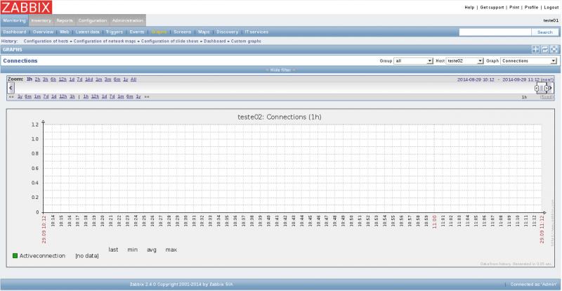

Hi
I would like to ask for help, I installed the postbix on my server but I cannot see any data, My zabbix is 2.4 and my postbix is 1.2.0-RC1 and 1.1.0 but nothing happens, please just check out below my postbix output
PLease I had type the Select in psql command line but it is ok , but my items inside the zabbix doesn't get data...
Cheers
