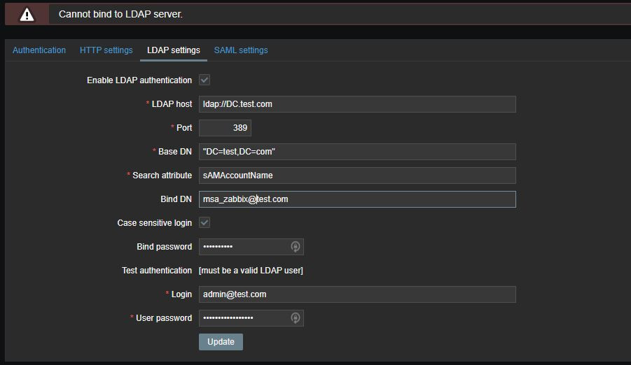

    Hi there,
    I seem to have an issue with setting up LDAP authentication with Active Directory, these are my settings:
    I am able to run ldapsearch without any issues to the same base DN that I am using for the configuration. However when I run it on zabbix it does not work, showing the cannot bind to LDAP error.

        synex 's screenshot shows config for an LDAP simple bind over a clear text channel.
        Microsoft is phasing out any support for that, as it's a very insecure config. Your Active Directory admins may have already made the changes that prevents AD from allowing that.
