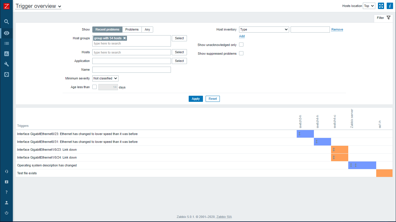

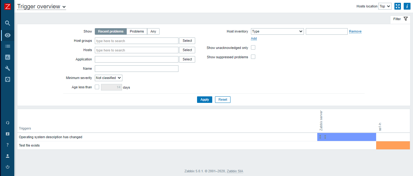

    Hi All,
    Some further information: I now have a few more alerts triggering and it seems that all alerts from the switches are hidden on the overview are based on the number of hosts in the group. If I create a host group with just the switches in and filter to that group the alerts are shown. If I add more hosts to the group then I get to the point where each host I add to the group hides one of the switches alerts.
    Screenshots attached showing:
    - full problem list (4 switches with triggers)
    - overview with no filters (no switches visible)
    - overview filtered to group with 53 hosts (all 4 switches show)
    - overview filtered to group with 54 hosts (only 3 switches show)
    I tried increasing my users "Rows per page" to 60 with no change.
    Something seems to be truncating the list of hosts in the overview - causing some hosts to be hidden if there are a large number. I have 73 hosts in my setup, and so far have only seen this occur for the snmp monitored devices (although most devices are not generating errors so that could be coincidence)

    Trigger overview with no filters does not show any switch problems:
Name:	zabbix overview no filters.png

    Trigger overview filtered to group with 54 hosts hides one of the switches (switch5-c) problems:
Name:	zabbix overview - group of 54 hosts - 3 switches shown.png

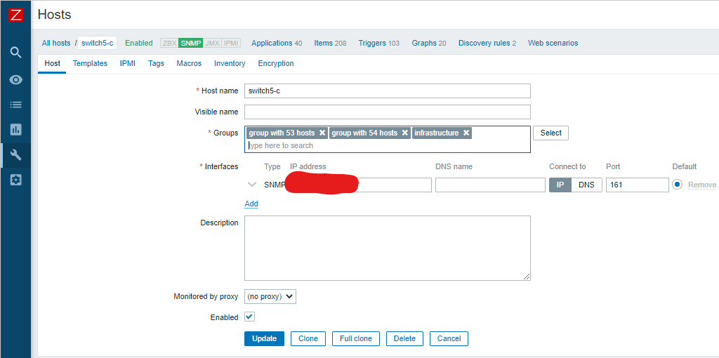

    Switch5-c is in both groups:
Name:	switch5-c groups.png
