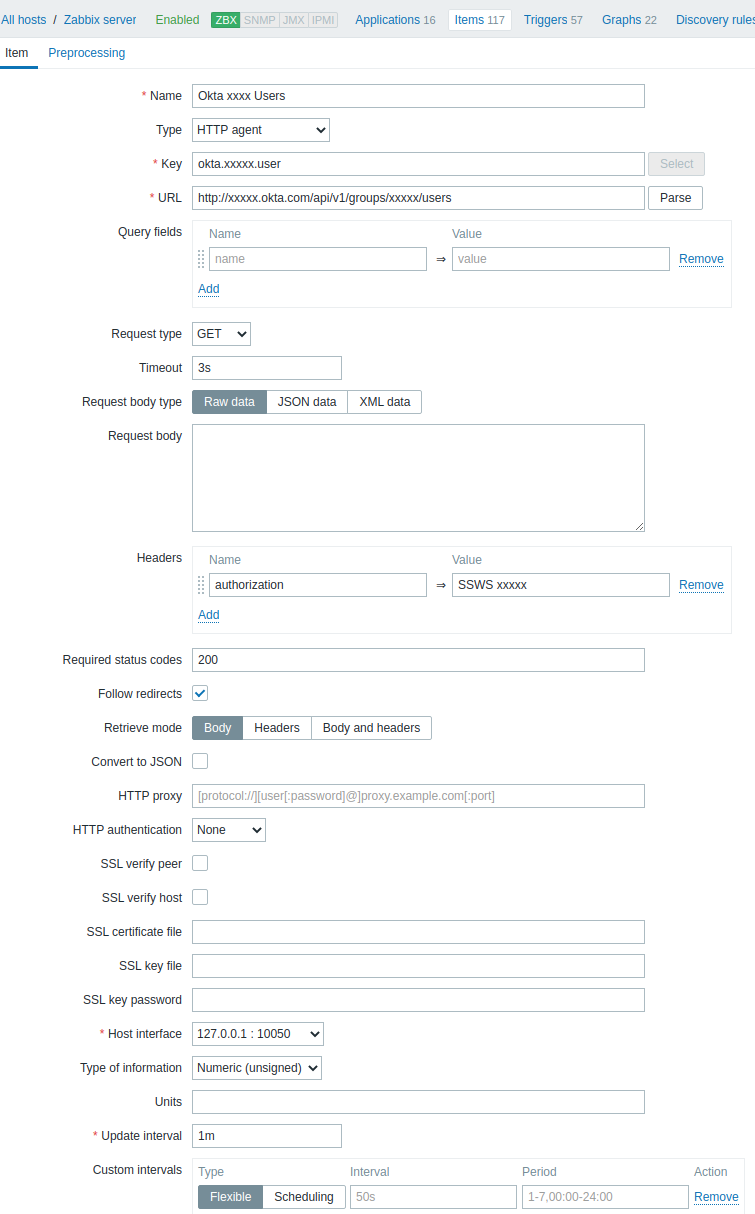

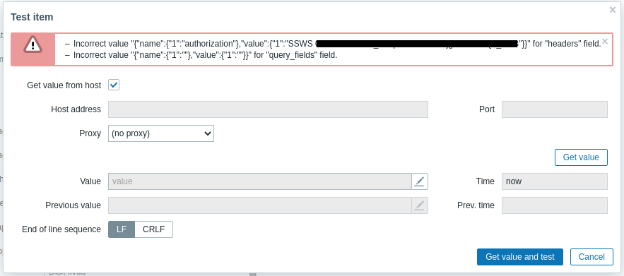

    Seeing the same behavior here too.
    Attempting to query an API using the HTTP Agent and seeing the same exact "Incorrect value" errors when I try to test the query.
    I've verified that the query works via curl on the agent, this works:
    curl -v -X GET \
    -H "Authorization: SSWS xxxx" \
    "https://xxxx.okta.com/api/v1/groups?q=xxxx"
    From Zabbix, this doesn't work:

      There's a bug report here
      With a patch available and notes about it being fixed in the next release.
