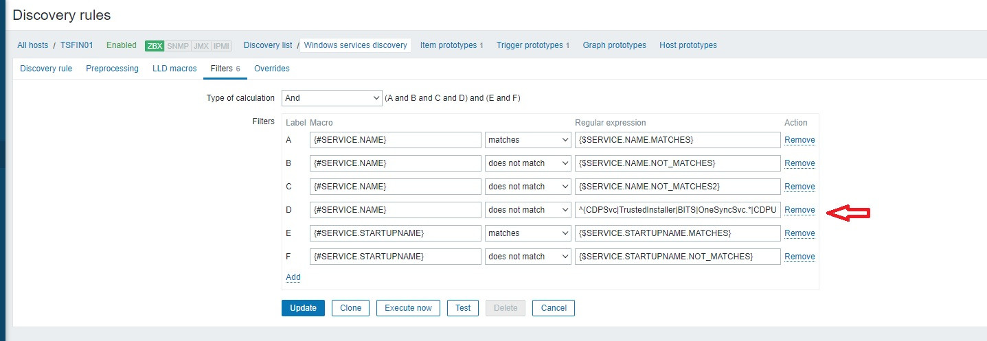

          WebGreg, thank you for the response. I added the suggested filter (option 2) last night, but today I seem to still be getting the "BITS" Problem coming back. I am new to Zabbix so any recommendations would be appreciated.
          I am sure that it's documented but there did you come up with the expression ^(CDPSvc|TrustedInstaller|BITS|OneSyncSvc.*|CDPUse rSvc.*)$

            You added exclude to the discovery rule. But your discovery is already done. The BITS has already been detected so how is the exclusion filter supposed to work? If you add this template to the new host - this service will not be discover,
            If you change something in template already implementet - you have to clear all data on this host and discovery it again. Or go to items (and triggers) and delete item already discovered manualy. I suppose on items tab you will see an annotation that this service has not been detected and will be deleted ... in a month.

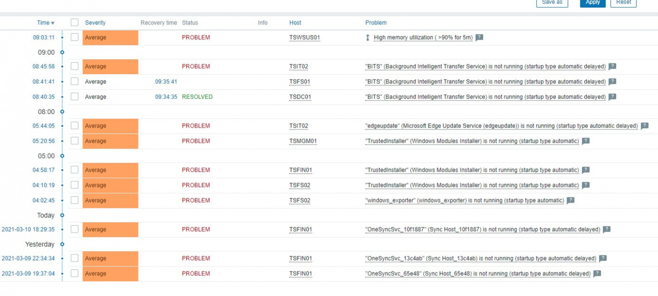

                I'm new to Zabbix and, same as others in this thread, I'm having trouble getting these Windows service alerts to stop. Of course this feature is very useful for 95% of the services, but there's a few services that don't behave in the same way. Here's what I have in my 'Regular expressions' section.
                Result is FALSE
                ^(MMCSS|gupdate|SysmonLog|clr_optimization_v.*|BIT S|WpnUserService_.*|CDPUserSvc_.*|CDPSvc|WbioSrvc| OneSyncSvc_.*|tiledatamodelsvc)$
                After setting that, I then went to Configuration > Hosts and deleted all my hosts. I then rebooted those machines so that they would re-add themselves to the Zabbix server.
                But unfortunately I'm still getting the same errors as before - even with BITS, which has no wildcards that could cause confusion.
                What am I doing wrong?
