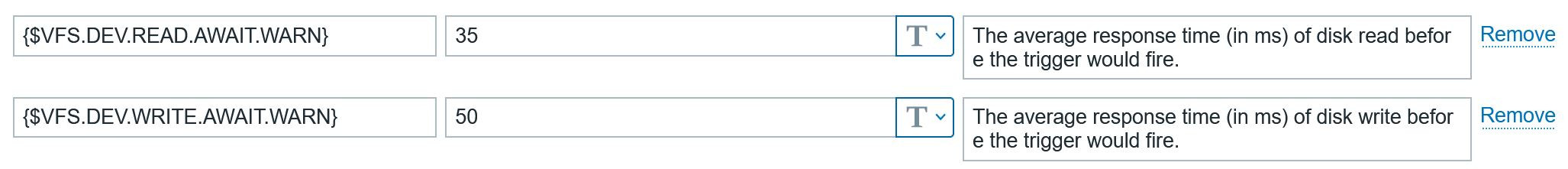

            I know this is a bit older post, but I have been getting hundred emails from my storage servers that use HDD with the default values of 20ms response times for read and write.
            After a lot off googling, I still did not find the answer on how to change the values, but finally figured it out. Below is how you can change the response times.
            I hope this helps a lot of people like me :-)
            How to change the Macro Values
            The trigger -- Disk read/write request responses are too high (read > 20 ms for 15m or write > 20 ms for 15m) -- is typically part of the "Template OS xxxx" templates.
            So first you need to figure out, where it came from (which template) -
            Just go to Configuration -> Hosts and see what template you are using.
            IN my case it was a Linux server.
            Next piece of information we need is what "Macro" needs to be changed. So go to the Monitoring -> Problems, then click on the "Problem" text - ( which may look like "sdb: Disk read/write request responses are too high (read > 20 ms for 15m or write > 20 ms for 15m)" ) and in the pop=up click Configuration
            You should see something like this. Note that the two Macro are $VFS.DEV.READ.AWAIT.WARN and $VFS.DEV.WRITE.AWAIT.WARN
            Also note that you are viewing the configuration of a single server, not all servers that use the template.
            We want to change the Template, not just one server.
            Now that you know which template its coming from, go to Configuration -> Template -> "Template OS Linux by Zabbix Agent" (use your actual template)
            Once template is open, Click on the "Macros" -> "Inherited and Templates Macros"
            Find the two macros and click on Change (screenshot shows Remove since I already changed it)
            Note I changed the values from 20/20 to 35/50 for read/write
            Finally, scroll to bottom of page and click UPDATE.
            The new values take effect immediately.

                  Hi, jackinthebox,
                  It works for me when we change the macro value, but I would like to check to explain about value that we have changed
                  {$VFS.DEV.READ.AWAIT.WARN} from 20 => 35
                  {$VFS.DEV.WRITE.AWAIT.WARN} from 20 => 50
                  Why would we change it? and is the value suite for SSD and HDD disk monitoring?​
