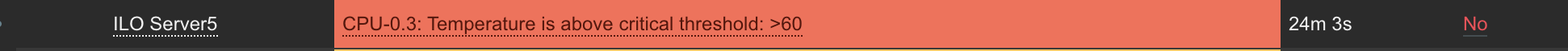

          Yes this problem has been resolved but this time I cannot fix similar problem with this method (create new macro with context {$TEMP_WARN:"0.43"}.)
          I added these macros:
          {$TEMP_CRIT:"0.25"} 80
          {$TEMP_CRIT:"System-0.25"} 80
          but I am still getting problem message:
          any help ?

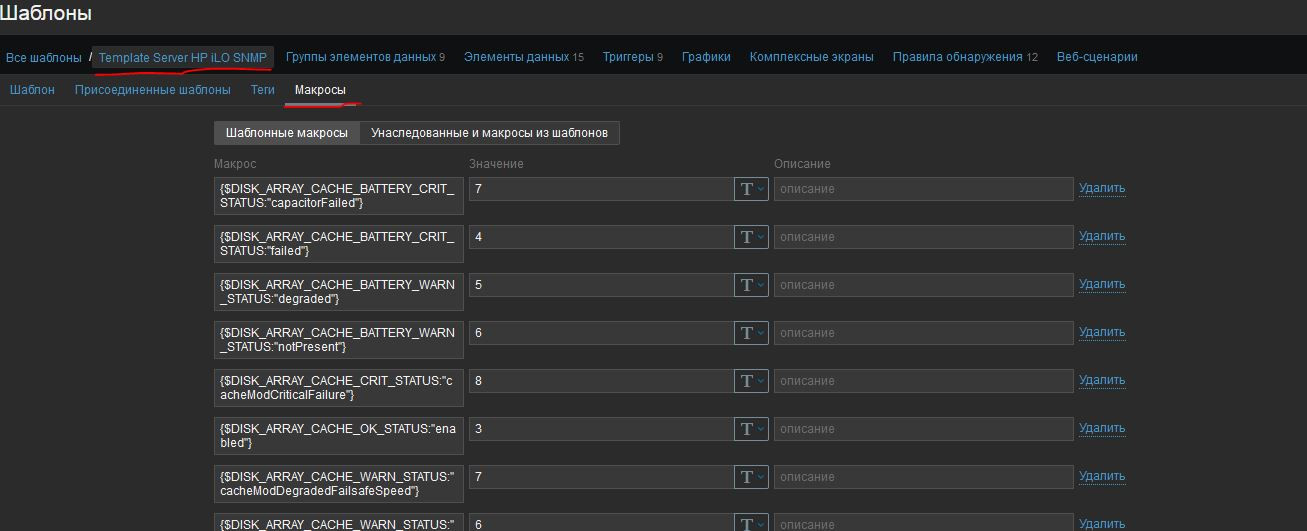

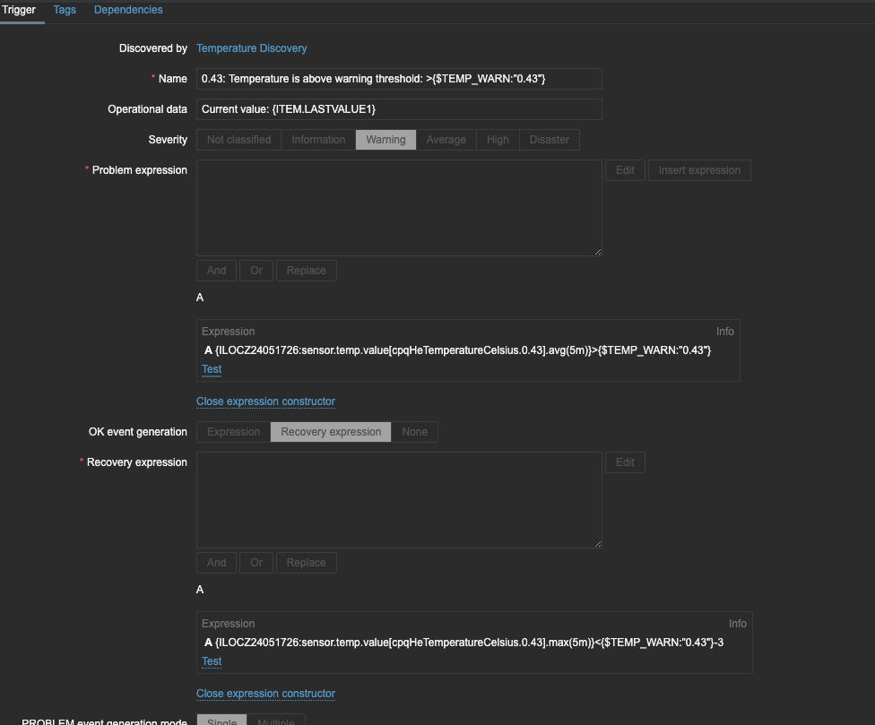

          • Aidar
            • Aug 2020
            template settings -> macros
