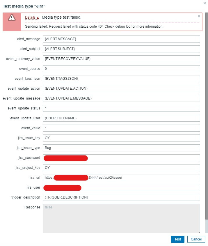

    I'm getting 404 error like below while testing Zabbix 5.0 Jira Webhook. I attached my configurations.
    While trying create issue on server cli with using api, the issue with named OY-xxx succesfully created.
    Can anyone help me?

    Media type test failed.
    • Sending failed: Request failed with status code 404 Check debug log for more information.

    When I removed the part from port number in jira_url it worked. So it should be like this:
