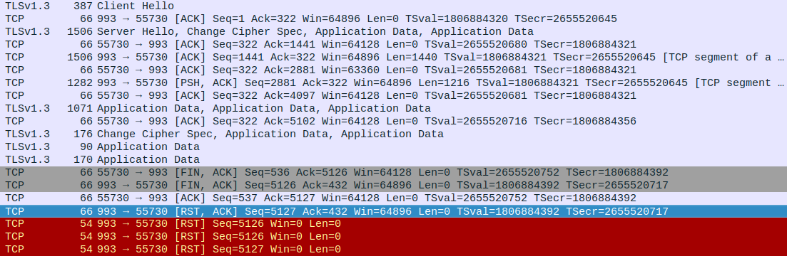

    NOW, there is another Ubuntu 18 machine, that did not have checked Certificate in Dashboard, nor has the agent_config been touched so far but right after we adjusted above server config, client does not send data anymore and just logs:
    4411:20200701:142814.601 SSL_shutdown() with OUR.ZABBIX.SERVER.HOST set result code to 1: file ../ssl/ssl_lib.c line 2072: error:140E0197:SSL routines:SSL_shutdown:shutdown while in init
    Server logs:
    1952:20200701:143615.854 failed to accept an incoming connection: from HOSTS_IP_ADDRESS: TLS handshake set result code to 1: file ../ssl/statem/statem_srvr.c line 3672: error:1417C0C7:SSL routines:tls_process_client_certificate:peer did not return a certificate: TLS write fatal alert "unknown"

    Tcpdump attached. (Yes, server listens on port 993 for testing)

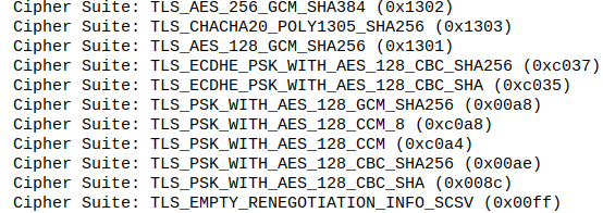

    Issue is with all ubuntu 18 systems we have. Client offers during TLS-handshake:
