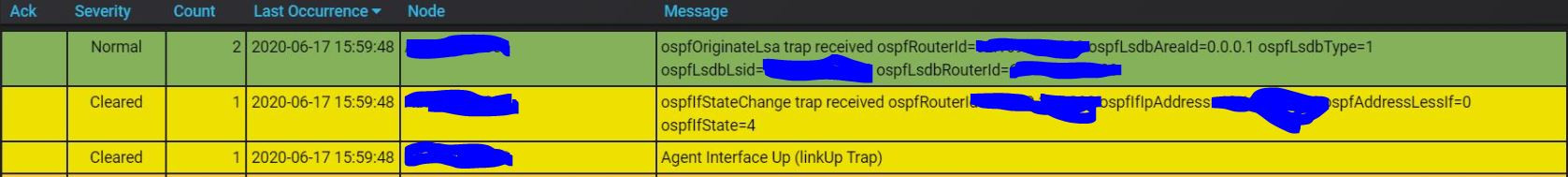

    2. Is it possible to have another view of the traps? e.g.
    Thank you
