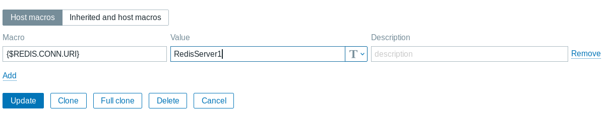

      Then go to zabbix server and select Redis Template for your hosts.
      Before you update add new macro to host `{$REDIS.CONN.URI}` and if you set Session to `RedisServer1`set value to`RedisServer1` as well .
