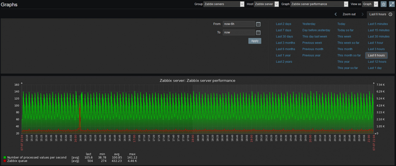

    Hello Guys,
    I am having trouble solving my Zabbix Server high queue issues. and I can't understand where the issue is.
    All proxies have 5seconds and lesser check in times. Network connectivity is all good. I have attached several screenshots that my help in accelerating troubleshooting.
    I also have checked on my host if there are some kind of throttling but they say that my VPS is performing optimally and they don't see any obvious issue.
    VPS Specs (zabbix server) - Los Angeles
    4 vcpu / 8GB ram / 200GB ssd
    MariaDB: mysqld Ver 10.1.44-MariaDB-0ubuntu0.18.04.1 for debian-linux-gnu on x86_64 (Ubuntu 18.04)
    Zabbix Version: Zabbix 4.4.10
    I have 3 remote sites being monitored. Agents on those sites are monitored via the proxies and most monitors are snmpV2. Remote sites are in the Philippines.
    • I can assure you that the zabbix performance graphs for all proxis are flat on the Queues.
    Can you point me to places where I can check?

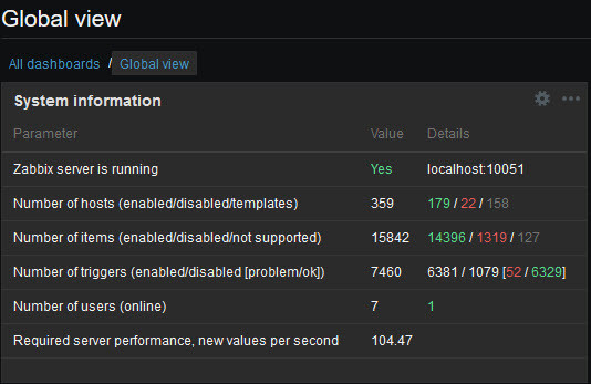

    Additional Info of my setup.
    Even with Proxy of 5.7 vps, zabbix server still shows queue from this remote site which I don't understand why for such a very low amount of data.
    Click image for larger version  Name:	zabbix-sys-information.jpg Views:	0 Size:	63.1 KB ID:	404715
