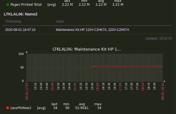

    I began using Zabbix only a few weeks ago and I am using it for printer monitoring through SNMP OIDs. I managed to get all of my values, but there is one thing that I just can't get through. So here's what I need help with:
    Each host (printer) has two items:
    • Name2 (cartridge model);
    • Level%Now2 (current level).

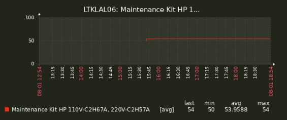

    I am trying to somehow get Name1 value into the name of LevelNow1 so that I could fit everything into one graph with value as the graph and cartridge name in the legend.
    I can't rename Name2 to a static value because the actual model differs between devices.
    What I have:

    What I want:
    Has anyone had a situation like this and, maybe, could share what they know?
