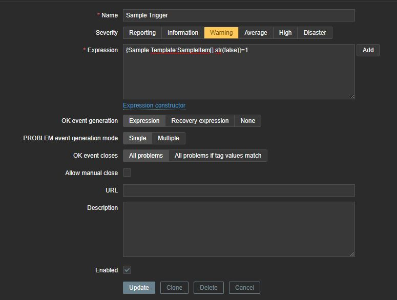

    Yes, since you are using only one parameter to str() it will always evaluate the latest value. Your expression looks correct and the problem should resolve after receiving "true" value. Could you show the configuration of your trigger, especially these options:

      Here is the trigger in question. I did remove some personal information as this is a custom user parameter item but otherwise the configuration is the same.

        Looks good. How often is your configuration reloaded by the server (option CacheUpdateFrequency in zabbix_server.conf)?
