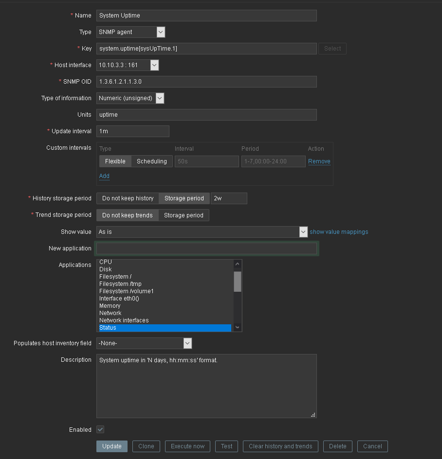

    Uptime from the below configuration is showing 311 days. The device has only been up 3 days.... What do I need to fix?

    Item Configuration:
    Click image for larger version  Name:	Capture.PNG Views:	0 Size:	19.3 KB ID:	407801

    Use snmpget from the command line to get the actual value returned by the device. Refer to the device MIB/OID doc on what the value represents. You can "scale" incorrect SNMP values with item preprocessing in zabbix. (Check if there is any preprocessing in place now too)

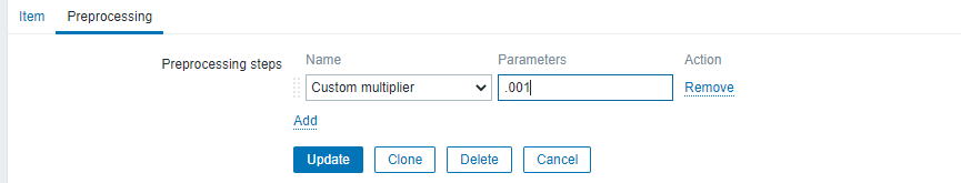

      Should be just add preprocessing to the item, something like tihs
      • LenR
        • Sep 2009
        • 1011
        Or .01, I didn't intend to have .001...
