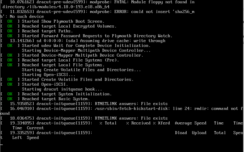

    I decided to try building a Zabbix server using the Appliance version 5.0.3
    I downloaded the zabbix_appliance-5.0.3-netinstall.iso and I created a VMWare VM with 4 vCPU, 16 GB RAM, 1 VMXNET NIC and 100GB disk but the VM hangs at the same point every time.
    I have tried different disk controller types but always same result. I only have ESXi 6.5 (HW version 13) and I selected CentOS 7 as the VM operating system. How tricky should this be?
