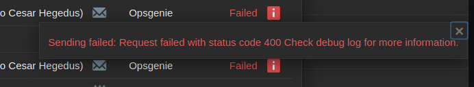

      But on the 4.4.5, because this second call fails, he keeps repeating the alert, as if it hadn't created on OpsGenie side ( again, he did and I got the requestID)... and after 3 tries (default) he gives up with the error 400:
      Click image for larger version  Name:	error.png Views:	0 Size:	22.2 KB ID:	408504

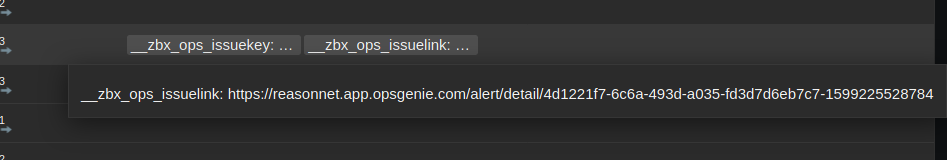

      After testing on the Version 5.2 I see he creates this, after successfully doing all the steps:
      Click image for larger version  Name:	result.png Views:	0 Size:	19.5 KB ID:	408505
      So yeah... I cannot explain this behavior, I really tried a zillion things , for me it seems the only solution is to remove the code that makes the second GET-Alert call and do without the tags with the link to the Alert on opsg...

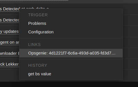

        It is worth mention that the second call will create this veeeery handy and brilliant menu:
        It would be a pity to break that functionality.
