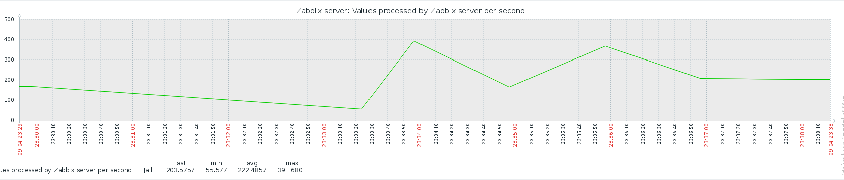

        vps during the backup time

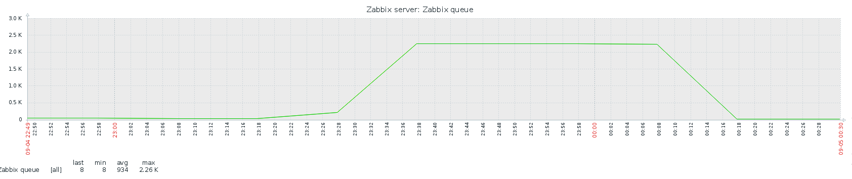

        zabbix server queue during the backup time
Name:	Screenshot at 2020-09-05 00-43-49.png

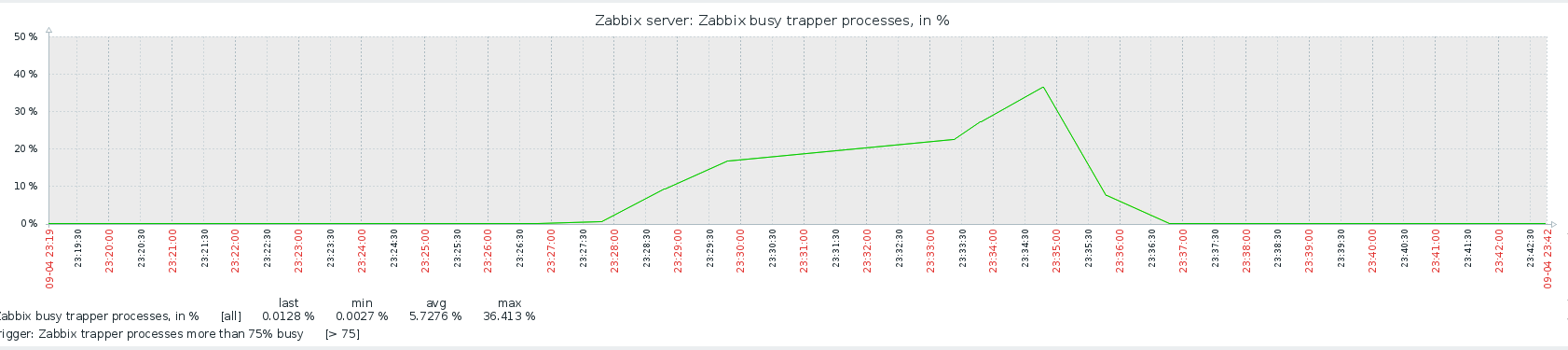

        Bussy trappers
Name:	Screenshot at 2020-09-05 00-45-28.png
