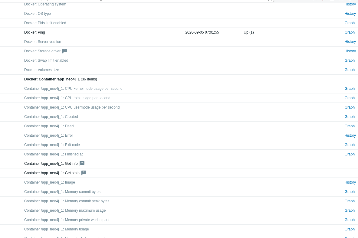

    I have Zabbix 5.0.2 running, on a host where I want to monitor the agent2(!) is running. The Zabbix user has been added to the docker group.
    Ubuntu 20.04 on both nodes and docker 19.03.12
    But only 2 things are working:
    a)
    Docker: Ping 2020-09-05 07:01:55 Up (1)
    b) the container discovery
    But nothing else:
    I need to mention that I switched every item and other thing to ACTIVE instead of passive template, but that shouldn't make a difference right?
    Any ideas? Those are 2 fresh VMs too, it's all default
    Thanks for any help

    Does zabbix agent user have access to docker sock file?

      Yes, I checked permissions and socket.
      I never got this working in active mode, the moment I reverted back to a passive template it worked at once.

        But I have to say that graphs dont work, cpu/memory for container graphs all have 'no data' despite data being there in latest data

          For me what worked was to add the Zabbix user to the docker group. I had the same problem or very similar it looks like.
          usermod -aG docker zabbix
            worked for me!
