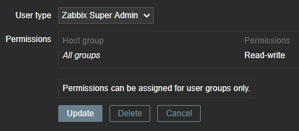

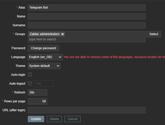

    User:
    Click image for larger version  Name:	u1.PNG Views:	20 Size:	23.9 KB ID:	410289
    Click image for larger version  Name:	u2.PNG Views:	19 Size:	13.1 KB ID:	410290​
    Click image for larger version  Name:	u3.PNG Views:	20 Size:	9.8 KB ID:	410291

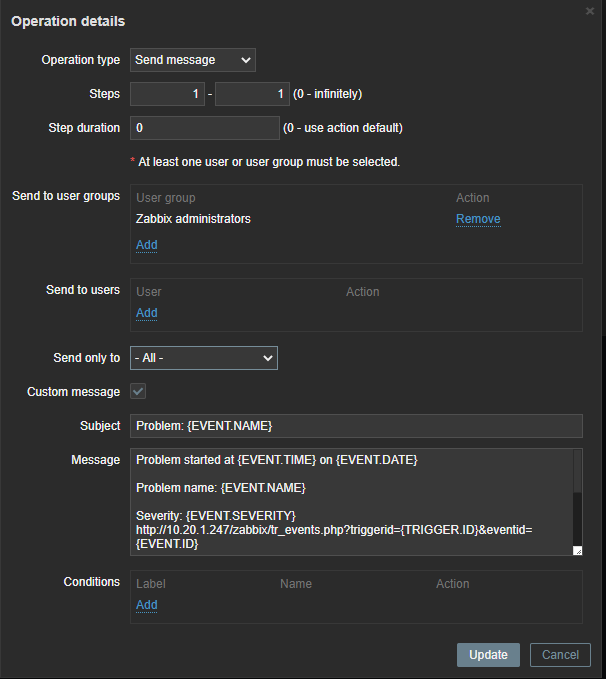

    Action:
    Click image for larger version  Name:	TeleOperation.PNG Views:	27 Size:	36.9 KB ID:	410288
    I'm new to Zabbix so i would assume that i did some stupid configuration mistake, but I can't find out what it is. Any help is appreciated

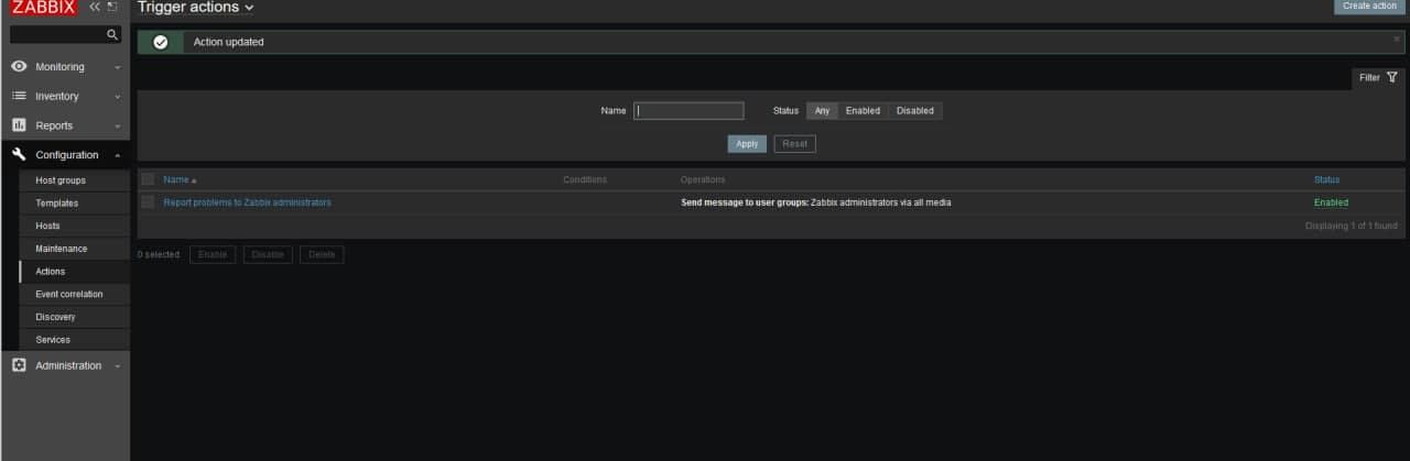

    • Mate1213
      • May 2021
      Hello!
      I just figured out, you need to enable the notification, in the actions page.
