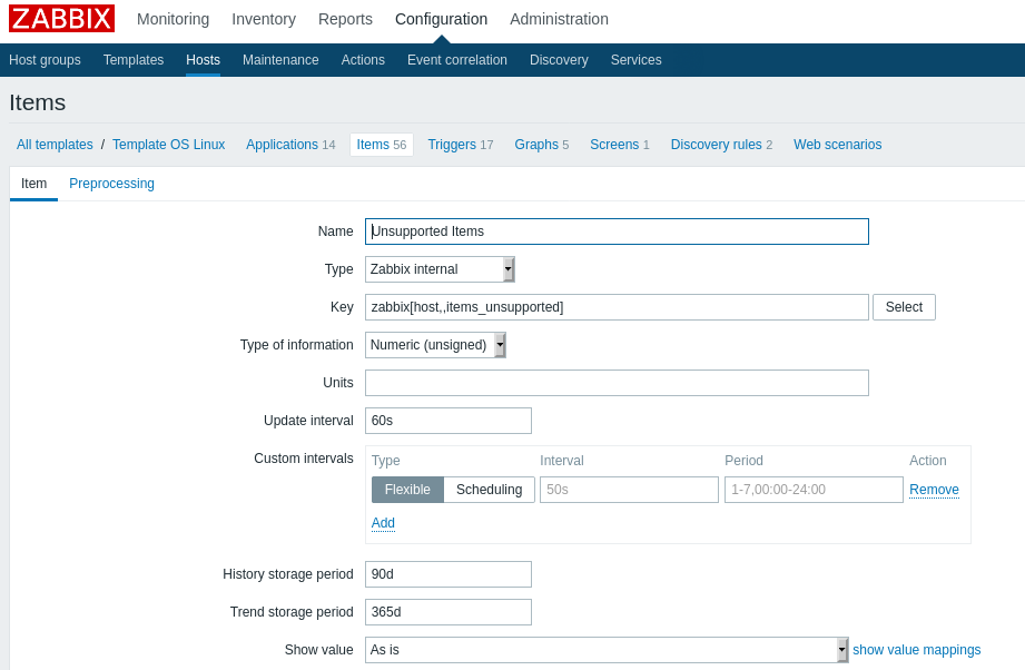

    I want a total on all unsupported items, today i have an item on each host: "zabbix[host,,items_unsupported]" which returns the number of unsupported items.

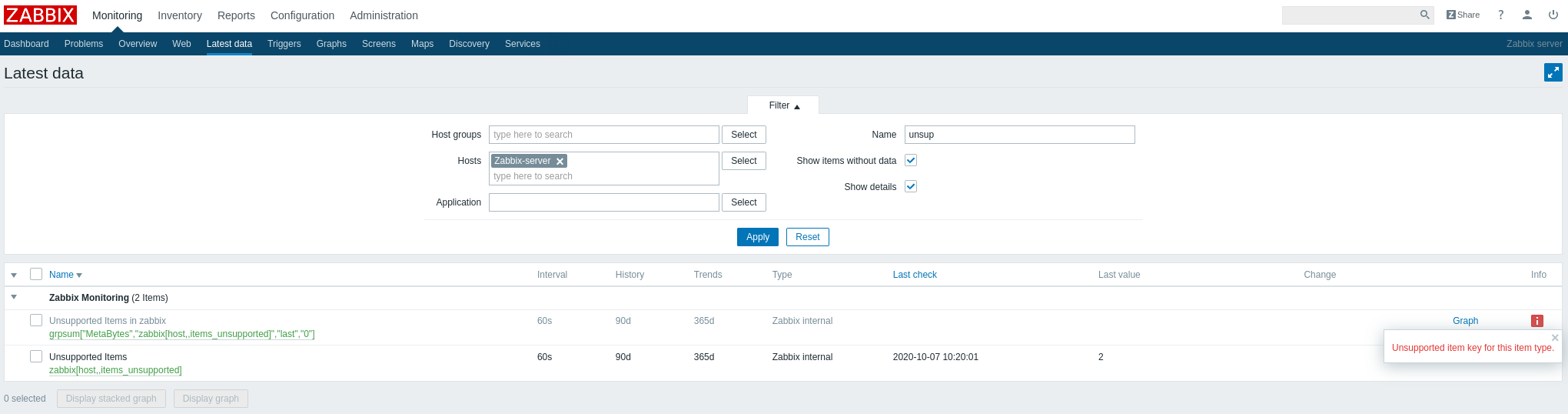

    ive tried this but it doesent work:
    grpsum["myGroup","zabbix[host,,items_unsupported]","last","0"]
    The error i get is this: "Unsupported item key for this item type."

    • darktux
      • Apr 2013
      • 11
      This one works for all my hosts, returning the sum of items unsupported.
      This does not:

        The grpsum item must be of type "Zabbix aggregate", instead of "Zabbix internal". I was surprised we had no word about it in our docs:
        https://www.zabbix.com/documentation...ypes/aggregate
        Will try to fix that.
