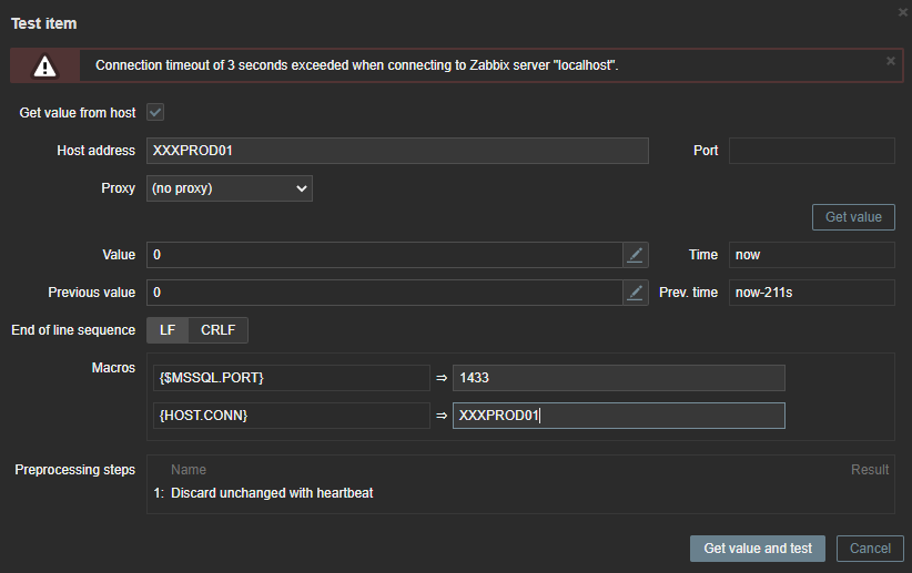

    I am trying to test the most simple item so I mean MSSQL: Service's TCP port state with key -> net.tcp.service[tcp,{HOST.CONN},{$MSSQL.PORT}]
    When I am clicking TEST I have to enter Host address (XXXPROD01) and in $MACROS {HOST.CONN} ? I am attaching screenshot with error.
    Should I change sthg? Add sthg in configuration? Did I miss sthg ?

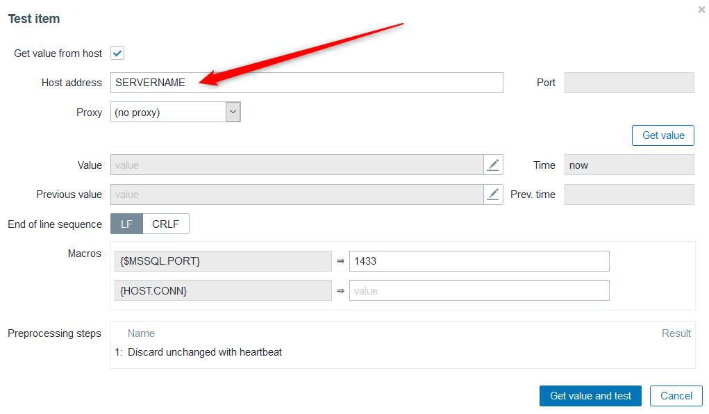

        You should check it as below (type only server name - not name of odbc connection)

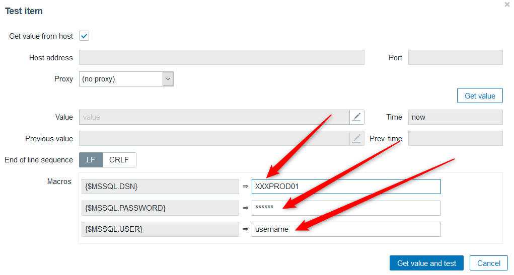

        If you want to check odbc try MSSQL: Get performance counters as below.
        {$MSSQL.DSN} -> name of odbc connection. In your case XXXPROD01
        {$MSSQL.PASSWORD} -> password for sql user
        {$MSSQL.USER} -> login of sql user

          I know that it is easy, but when I tried to test item (simple check type) I stil have the same info:
          Connection timeout of 3 seconds exceeded when connecting to Zabbix server "localhost".
          I searched already forum for this error, but I found nothing interesting.
          EDIT: seems be after reading other sources that it can be problem with zabbix configuration. I checked hostname option for passive checks and active checks in configs. Also checked /etc/hosts. Something is wrong here regarding my error with localhost.

              EDIT part 2: Works simple check - problem was with selinux after few restarts of zabbix-server. Now it is better. Time to check odbc.

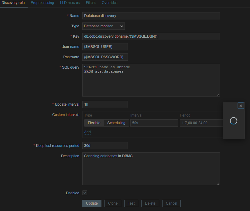

                ODBC is not working. I tried the simplest:
                db.odbc.discovery[dbname,"{$MSSQL.DSN}"]
                It is freezing as showed on new attached screenshot
                EDIT - SOLVED - capital letters in SQL query helped Very strange, but works fine!
