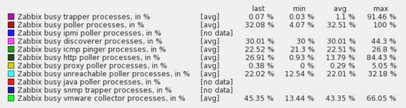

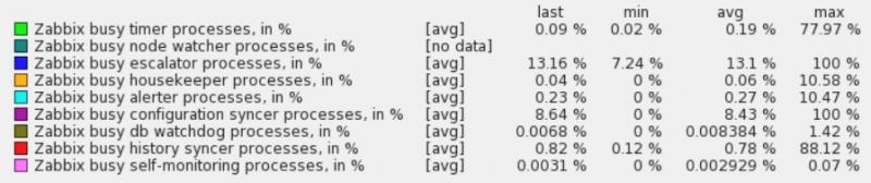

          • gleepwurp
            • Mar 2014
            • 119
            Hello Ingus,
            I don't have any spikes to speak of, and the CPU is idle...
            I'm posting the graphs for the Zabbix Server stats below, when I had this issue:
            Well, forget posting the Perf/Process graphs, seems I have a 100k quota for total picture attachment... I'll just post the Min/Max/Avg for Poller and Processes during the period where there was around ~80k items in the queue (period is about 1 day, 20 hours).
            The High MAX values are usually at the end, when Zabbix seems to wake up and process all the back log (lasts about 2-3 minutes at most).
            Gleepwurp.
            • ingus.vilnis
              Zabbix Certified Trainer
              • Mar 2014
              • 908
              Hard to tell much from these figures. AVG 1.1% trappers is not optimal. Alerter and history syncer also could be better. CPU is not so important here. I can hardly remember a case when there were any significant CPU load at all. But that's all.
