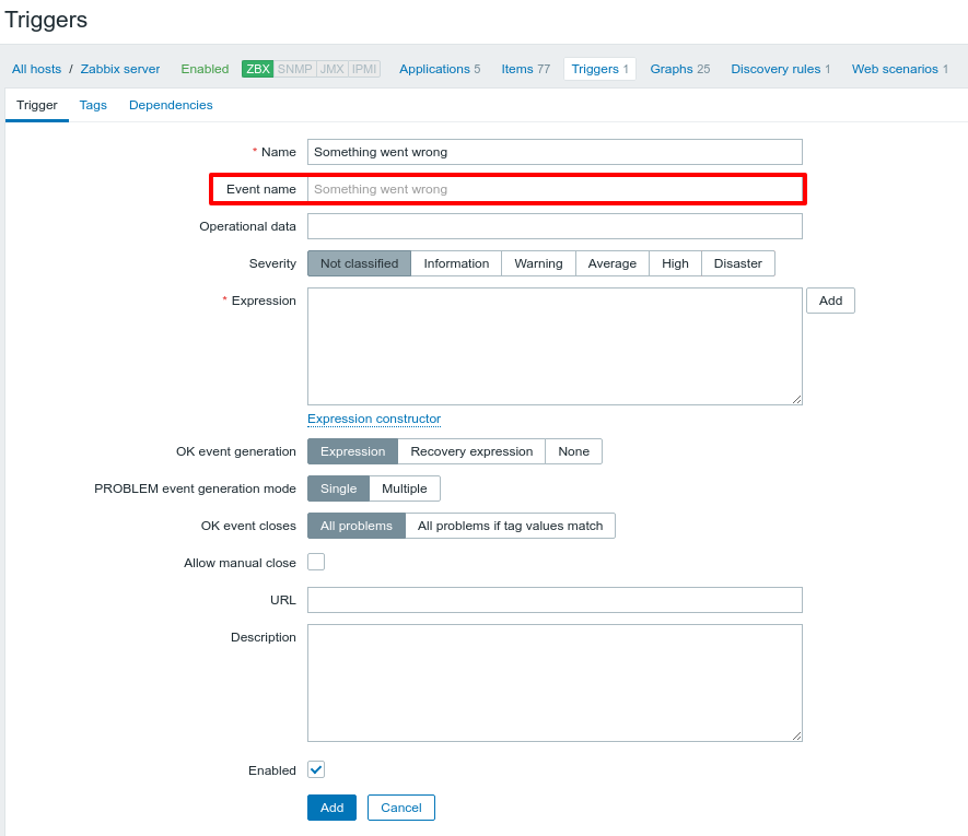

    Additionally, in 5.2 you get the possibility to set the name of the events that a trigger generates. A new field "Event name" will let you specify the name with macro values corresponding to the time of the event. The feature is ready (you are welcome to try out 5.0.2rc1), but not yet documented, it will appear there ASAP here: https://www.zabbix.com/documentation...iggers/trigger

        The event name will not be the same as trigger name used to be. If that helps, since 4.4:
        - trigger name: {ITEM.LASTVALUE} evaluates to the value that caused a trigger to fire
        - operational data: {ITEM.LASTVALUE} evaluates to current value
        - event name: {ITEM.LASTVALUE} evaluates to the value that caused event generation (be that problem event or recovery event, their names will be different, and the name will be stored in the database)
        If you don't specify event name it will duplicate trigger name:
