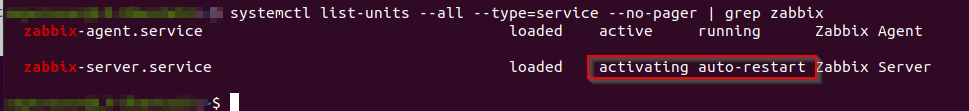

    - with -> systemctl list-units --all --type = service --no-pager | grep zabbix -> the status checked
    I am not good in Linux, the result is a bit confusing for me: -> Result: zabbix-server.service | loaded | activating | auto-restart | Zabbix server
