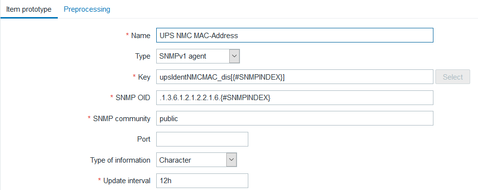

    I create a Item that read the MAC-Addresse via SNMP....
    When I use a SNMP Browser I receive the correct mac-address like 00-20-85-E3-D0-79
    Herr is the Item Config, no Preprocessing is configured
    .Click image for larger version  Name:	2020-11-03_09h08_14.png Views:	0 Size:	17.9 KB ID:	412189​
    But in Zabbix, I only see the Value like 0-20-85-E3-D0-79.... the first 0 is missing
    Any Idea?
