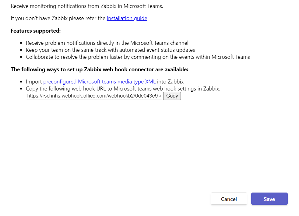

                  Having the original problem, the webhook URL from Teams does not work for my MS TEams Media type, as preconfigured from Zabbix 6.4
                  • Argon0
                    • Mar 2023
                    • 51
                    But the 'generic' incoming webhook DOES work.
                    • Argon0
                      • Mar 2023
                      • 51
                      OFFS... the SAVE button is off screen unless you scroll down. So you need to know it is there
                      Save is below the line....Click image for larger version
                      <GROAN>
