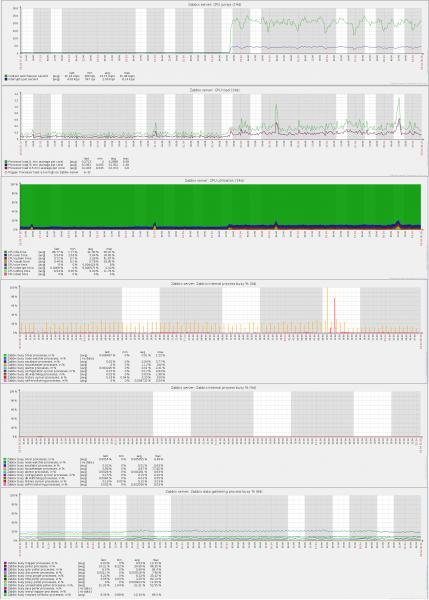

since update to 2.2.9 zabbix need more ressources and get more false positives alarms
  • Colttt
    Zabbix Certified Specialist
    • Mar 2009
    • 878
    last Thunday(02.04.2015) i upgraded from 2.2.6 to 2.2.9..
    At first all works fine but then i get often Alarams, for example no SNMP Values for more than 5minutes or high ICMP response time (icmppingsec).. so i look at some server stats and see that zabbix need more ressources and i have a higher load..
    I Hope someone can help me..

    Please post your graphs again, but with higher resolution (e.g. use some 3rd party image hosting). I can't read your metrics.

      Hello jan.garaj
      here an pic in better resolution, thanks for help!

        Usage is pretty low. Only jumps have been increased significantly.
        Investigate:
        - context switches
        http://unix.stackexchange.com/questi...-process-makes
        - interruptions
        cat /proc/interrupts

          thanks for this hint, but also are the response time are higher (avg) since i have upgraded to zabbix 2.2.9

              Soo.. here are some investigations..
              cat /proc/interrupts >> interrupts_0; sleep 60; cat /proc/interrupts >> interrupts_60
              diff interrupts_0 interrupts_60
              10c10
              <  15:      86442      69109   IO-APIC-edge      ata_piix
              >  15:      86472      69138   IO-APIC-edge      ata_piix
              44,45c44,45
              <  72:   31920493       3633   PCI-MSI-edge      eth0-rxtx-0
              <  73:         54   27389735   PCI-MSI-edge      eth0-rxtx-1
              >  72:   31932179       3633   PCI-MSI-edge      eth0-rxtx-0
              >  73:         54   27400534   PCI-MSI-edge      eth0-rxtx-1
              47c47
              <  75:    1616372    1035625   PCI-MSI-edge      vmw_pvscsi
              >  75:    1616910    1035716   PCI-MSI-edge      vmw_pvscsi
              51c51
              < LOC:   13098078   13972546   Local timer interrupts
              > LOC:   13102804   13978381   Local timer interrupts
              54c54
              < IWI:    1801915    1919114   IRQ work interrupts
              > IWI:    1802476    1919966   IRQ work interrupts
              56,58c56,58
              < RES:  294744456  294727503   Rescheduling interrupts
              < CAL:     527973     869043   Function call interrupts
              < TLB:     179710     180415   TLB shootdowns
              > RES:  294872443  294855571   Rescheduling interrupts
              > CAL:     528010     869298   Function call interrupts
              > TLB:     179796     180509   TLB shootdowns
              62c62
              < MCP:        534        534   Machine check polls
              > MCP:        535        535   Machine check polls
              soo the eth0-rxtx-* are high (IMHO) around 11000
              soo but when i do this:
              pidstat -wIt 10 1 >> pidstat_0; sleep 60; pidstat -wIt 10 1 >> pidstat_60
              diff pidstat_0 pidstat_60

              > Average:      109      1596         -   5321.12      1.79  zabbix_server
              > Average:      109         -      1596   5321.12      1.79  |__zabbix_server
              > Average:      109      1597         -   5249.90      1.99  zabbix_server
              > Average:      109         -      1597   5249.90      1.99  |__zabbix_server
              i think that is a Problem with zabbix_server..
