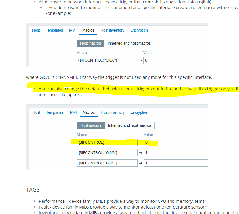

    Hello.
    Testing Zabbix as an appliance.
    Successfully snmp to my HP Procurve switch.
    I applied macro {$IFCONTROL} with a value of 0, in an attempt to filter or prevent discovery of access ports.
    No luck. I get 1000+ items discovered.
  • Hamardaban
    • May 2019
    • 2714
    Based on what is written in the documentation (and highlighted by you) these macros affect trigger handling, but not LL discovery.
    In other words, all ports will be found. but for some, the triggers won't fired.
