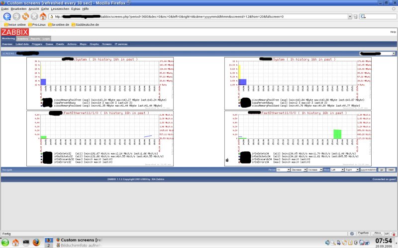

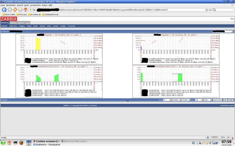

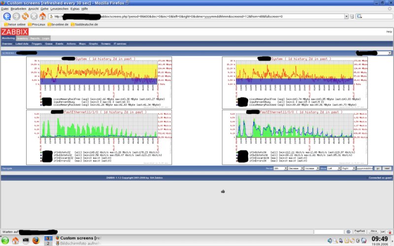

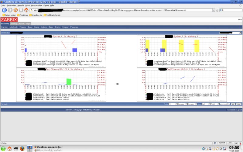

            I'm afraid but I do not see much improvment after the first runs of the housekeeper.
            I've two grapsh for you, the first one is taken from data collected before the update to 1.1.1.
            The second image is taken a few minutes ago from the now working 1.1.2 installation. I have done no changes to the number of monitored hosts and items nor the number of running server processes.
            Any hints how to resolve this issues?
