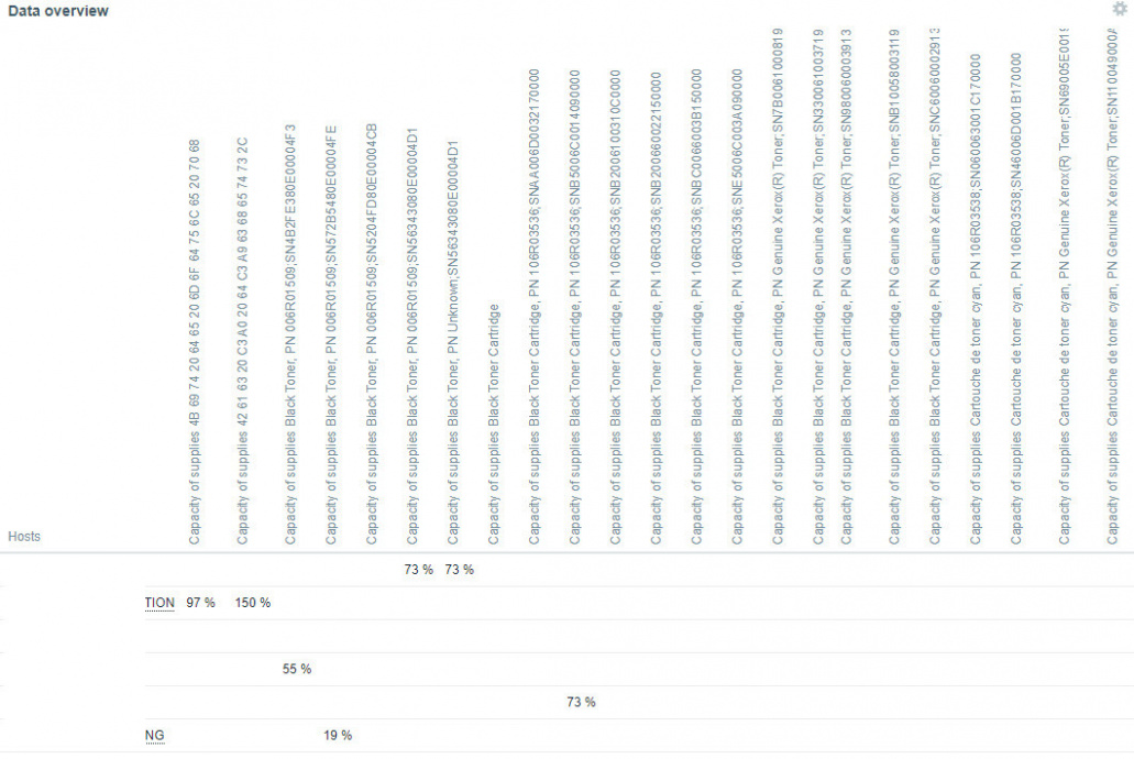

    Furthermore, when I want to create a new widget (data overview for example), it seems there's one trigger for each toner + for each printer. A picture will speaks better than me (on the left, some of my printers, on the top, all the trigger names?) :

    Do you know how can I homogenize the data, in order to have, for example, one table showing the 4 toners level ... ?

    Regarding the odd trigger names, I'd say there's macros in the trigger names. These resolve to whatever is discovered on each device, meaning if the SNMP database on your printer has a table entry called "SNunknown" there is going to be an item and a trigger for that object.
    Try checking up on the tables for instance with an snmpwalk over the prtMarkerSuppliesEntry table (1.3.6.1.2.1.43.11.1.1) and see what you find.
    In the widget, the item names are on top. If you want a different look on things with a data overview widget you can set "Host location" to top.
